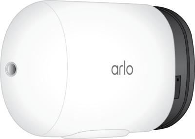

2. Press the button on the magnetic charging port to release the camera from its housing.
3. With a click sound, the camera slides partially out of the housing.
4. Pull the camera until it separates from the housing.

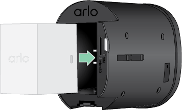

5. Remove the battery.

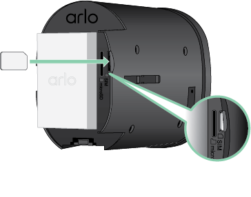

6. Insert the activated SIM card into the camera’s SIM card slot. Tip: Align the SIM card so that the side of the card with the notch is at the top, as shown.
7. Press the edge of the SIM card until it locks into place and you hear a click.
8. Replace the battery.
9. Slide the camera back inside the camera housing until it clicks.
