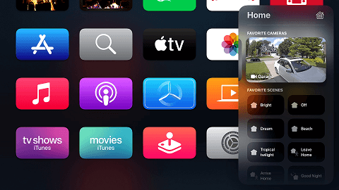

To view your Arlo camera on Apple TV:
- Connect your compatible Arlo camera to Apple HomeKit.
For more information, visit How do I connect my Arlo camera to Apple HomeKit?. - Turn on your Apple TV.
- Do one of the following:
- Press and hold the Siri button on your Apple TV remote, and say “Show [camera name].”
Note: The camera name is the one that you gave it in the Apple Home app, when you first connected the camera to Apple HomeKit. - Hold the TV button on the Apple TV remote to bring up the side menu, then click a live stream.
