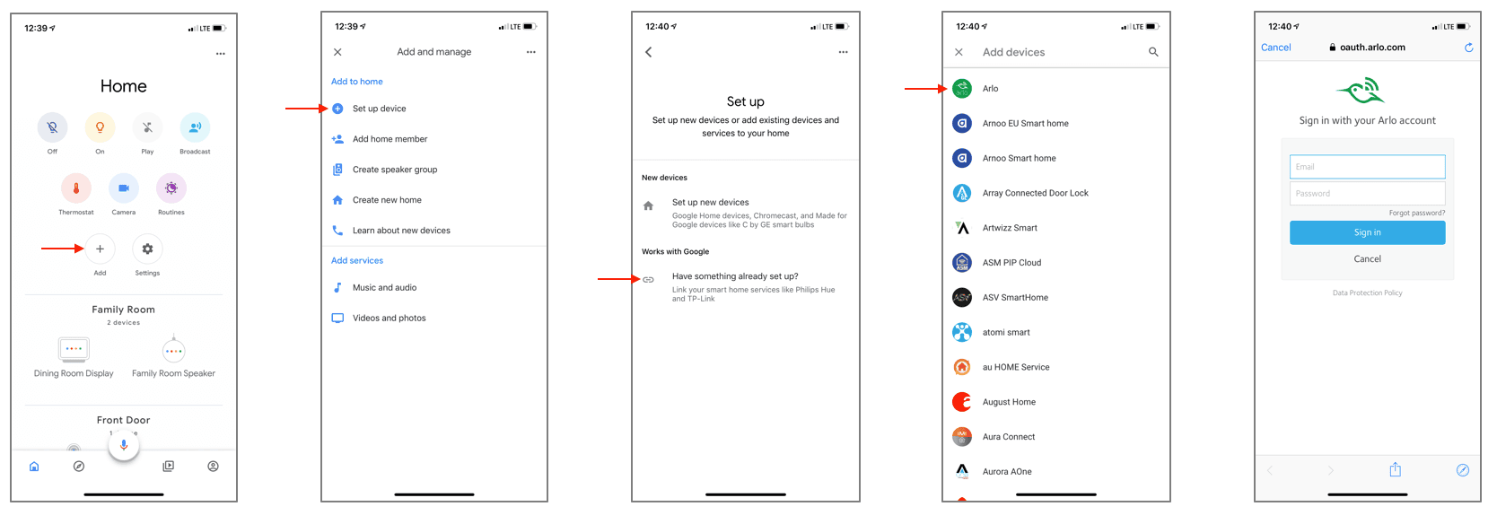

Connect Arlo to Google Assistant
To connect your Arlo cameras to the Google Assistant app:
- Launch the Google Assistant app.
Make sure you are on the home page. - Tap the + icon (Add).
- Tap Set up Device > Have something already set up?.
- Select the Arlo icon from the list of device options.
Note: You can search for Arlo or scroll down until you find Arlo on the list of devices. - Sign in with your Arlo account.
Your Arlo camera is added to Google Assistant. - To test your camera, say “Hey Google, show [name of room where camera is placed] on [name of Google device].”
- To end the stream, say “Hey Google, stop [name of Chromecast device].”
