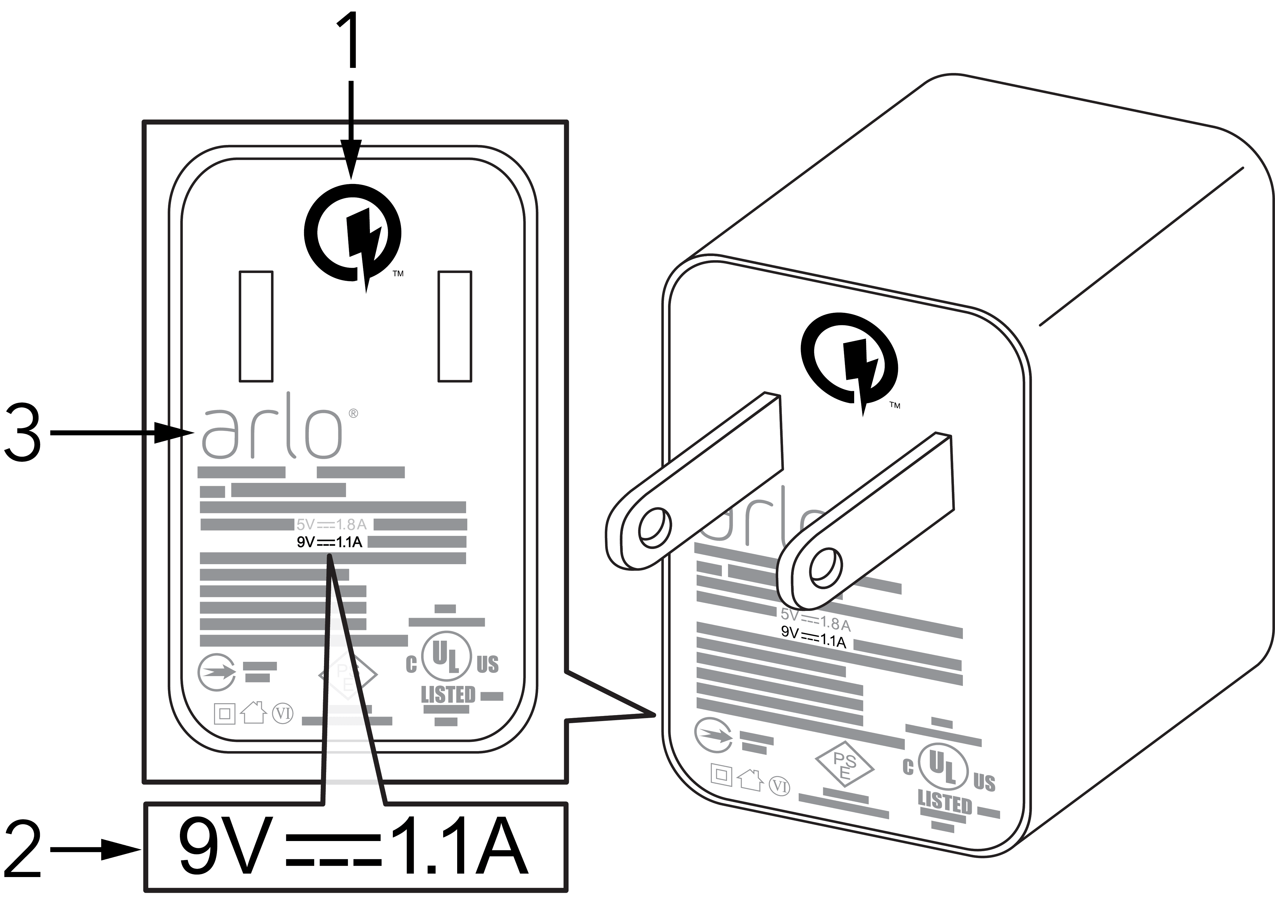

First, make sure that you’re using the correct power adapter:
Check for the following three things on your power adapter:
- The QC 2.0 icon. This is the lightning bolt icon at the top of the image.
- The output is 9V===1.1A.
- An Arlo or NETGEAR logo.
