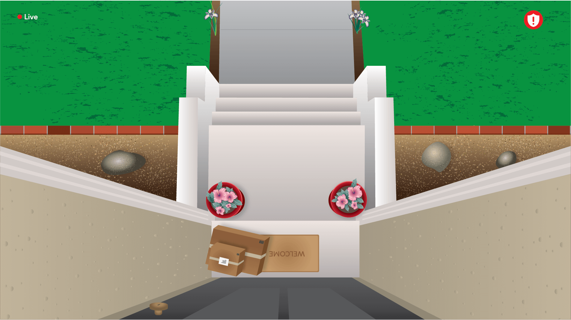

The image below is a good example of placement, view, and distance for an Arlo camera to detect packages. The view captures the walkway up to the door and the door stoop, where packages tend to be left. There also isn’t any obstructions between the camera’s view and the package.
- Camera Placement. Place your Arlo camera about 10 feet high and angle it so that it has a clear view of the walkway up to your door and the area where packages are left. This gives your Arlo camera time to wake up before the package is picked up or dropped off.
- Camera Distance. An Arlo camera armed with Package Detection should never be more than 10 feet from where packages are left. While Arlo might detect packages that are further away, we advise that you follow our guidance for best results.
- Camera View. Your Arlo camera must have a clear view of the package to detect it. If an object, such as a pole, is partially blocking the package, your Arlo camera might not detect it.
