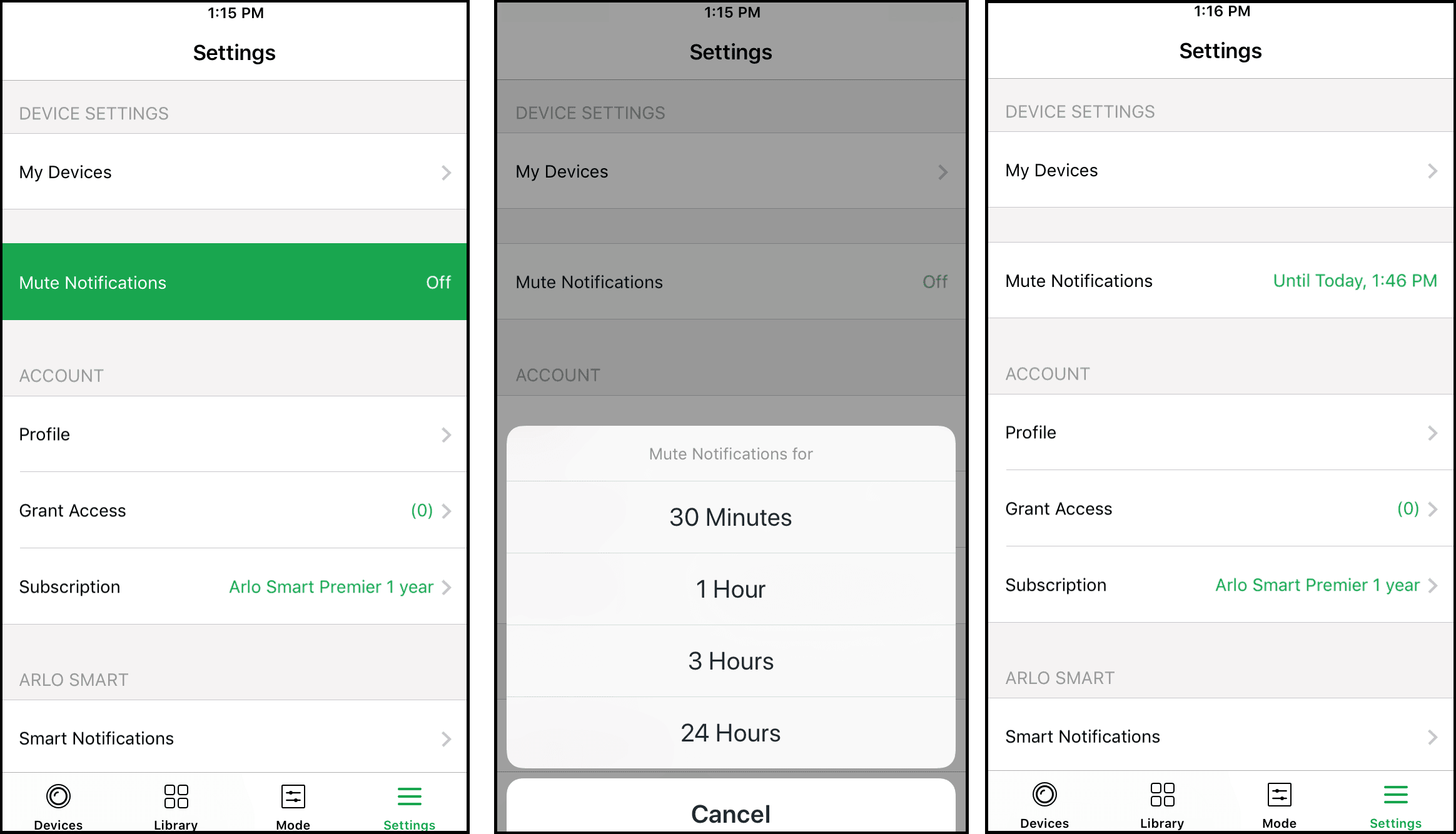

- In the Arlo app, navigate to settings and tap Mute Notifications.
- Arlo Smart with iOS only: When a notification displays on your mobile device, expand it and select Mute Notifications.
To mute notifications in the Arlo app:
- Launch the Arlo app.
- Tap Settings.
- Tap Mute Notifications.
A pop-up displays.
Note: If Mute is currently deactivated, it says ‘Off’ next to Mute Notifications. If Mute is activated, it indicates the time when mute was activated. - Select the amount of time to mute the Arlo app.

To extend Mute Notifications in the Arlo app:
- Tap Settings.
The Mute Notifications section displays the time when mute will expire. - Tap Mute Notifications.
A pop-up displays. - Tap Add 15 Minutes to extend the amount of time that notifications are muted.

To unmute notifications in the Arlo app:
- Tap Settings.
A pop-up displays. - Tap Unmute.
Push notifications are sent from the Arlo app.
