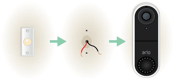

Install your doorbell
The Arlo Essential Video Doorbell Wired replaces your existing doorbell. You must connect your Arlo Essential Video Doorbell Wired to a 2.4GHz WiFi network.
To install your Arlo Essential Video Doorbell Wired:
- Remove your existing doorbell from the wall.
- Disconnect the wires from your existing doorbell.
Note: Make sure the wires don’t fall inside the wall when you disconnect them from your existing doorbell. You can temporarily tape the wires to the wall to prevent this. - Install your Arlo Essential Video Doorbell Wired with or without the mounting wedge that came in the box.
- The mounting wedge helps you angle your Arlo Essential Video Doorbell Wired left or right, depending on the position of your doorbell and the walkway to your door. For more information, visit How do I use the angled mounting wedge that came with my Arlo Essential Video Doorbell Wired?.
- Turn on your power at the breaker.
