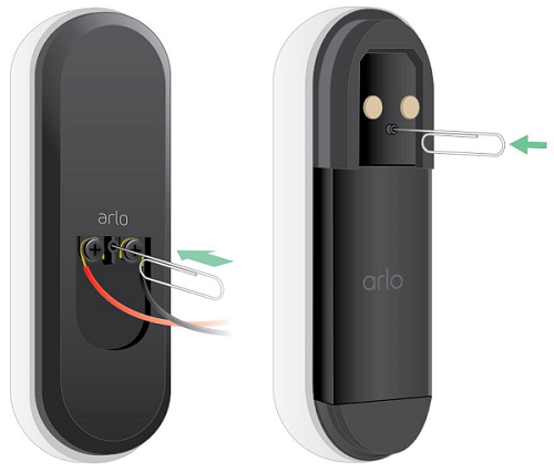

If the Arlo Video Doorbell is offline, factory reset the device using the reset button:
For the Arlo Video Doorbell (2nd Generation):
- Locate the release pin that came with your Arlo Video Doorbell.
Alternatively, you can also use a paper clip or a similar object.
- Press and hold the Pairing button on the back of the Arlo Video Doorbell for about 15 seconds.
The LED in front of the device flashes Amber when it successfully begins the reset process. After the reset is complete, the LED turns to blue and it is ready for pairing.
For the Arlo Essential Video Doorbell Wire-Free and Arlo Essential Video Doorbell Wired:
- Locate the release pin that came with your Arlo Essential Video Doorbell.
- Press and hold the Reset button on the back of the Arlo Essential Video Doorbell for about 15 seconds.
The LED ring around the doorbell button on the front of the device flashes white when it successfully begins the reset process.
