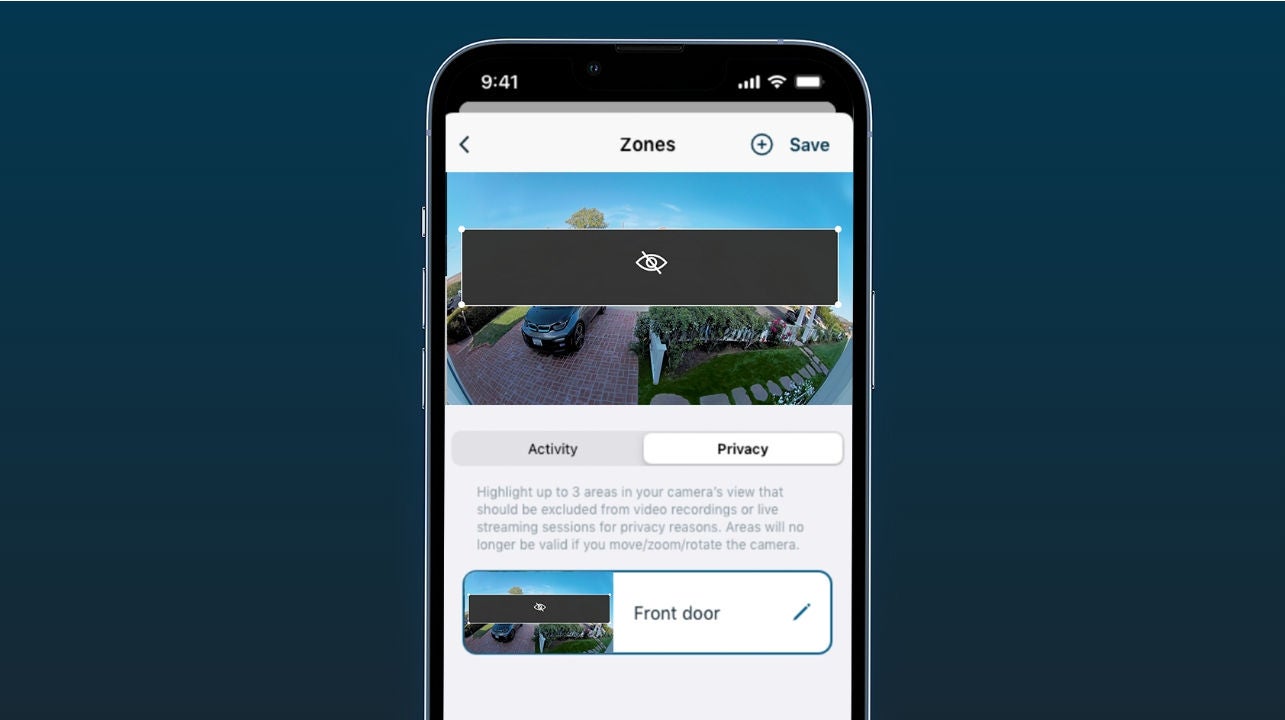

Set up Privacy Zones
Depending on the model you can create up to 3 Privacy Zones per camera, with either 4 or 8 anchor points to determine the size and shape of the zone.
Note: Arlo video Doorbell wireless support only 4 anchor points privacy zones instead of 8.
When created, the user will see all activity and privacy zones.
To create Privacy Zones:
1. Launch the Arlo Secure App.
2. Tap Devices.
3. Tap your device. ![]()
4. Tap
5. Tap Zones.
6. Select Privacy Zones.
7. Tap ![]()
8. To resize the Privacy Zone, tap and hold each anchor point and then drag the points of the zone to the desired size and shape.
9. To reposition the Privacy Zone, tap and hold inside the Privacy Zone and then drag the zone to reposition it.
10. To customize the Privacy Zone name, tap the pencil/edit icon, type the desired name, and tap Done.
11. To remove the Privacy Zone, select the zone, move the slider on the left side and tap on the red trash icon or DELETE.
Note: If you are creating a Privacy Zone for a camera that is compatible with Auto Zoom and Tracking, ensure that Auto Zoom and Tracking is turned off. Privacy Zones will not work when Auto Zoom and Tracking is enabled. For more information, visit: What are activity zones and how do I create them?
Privacy zones will no longer be valid if you zoom or rotate the camera.
More information about Privacy zones can be found in Privacy Zones FAQ.
