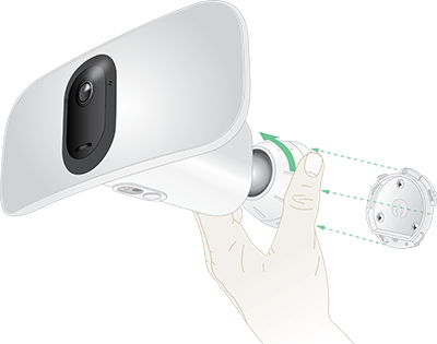

To remove your Arlo Pro 3 Floodlight Camera from the wall:
  1. Use a Phillips-head screwdriver to loosen the screw at the bottom of the camera housing’s grip.
  2. Turn the camera housing counter clockwise, and pull it from the back plate.
  3. Unscrew the screws from the wall plate, and remove the wall plate from your wall.
